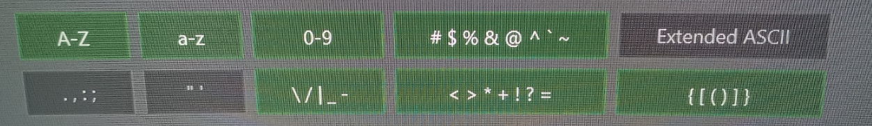

It is not possible for me to recreate my previously used password, as I use password manager, and it has replaced the previous ones and the previous passwords had not been visible to me, I just copied and pasted them. I can however show you which characters collections were in use previously to generate them (those highlighted in green on the attached screenshot). I hope that helps.
Edit: please click on the screenshot thumbnail, as there is more on the complete, full size picture, than on the picture preview.
