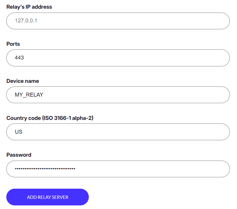

Now that your server is running all we need to do is add your private server's IP and port(s) in your admin panel:
That's it! Now all your Connect Anywhere connections will use your own server.
