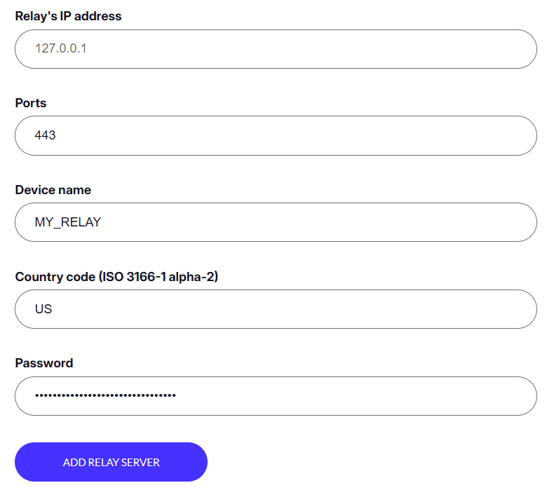

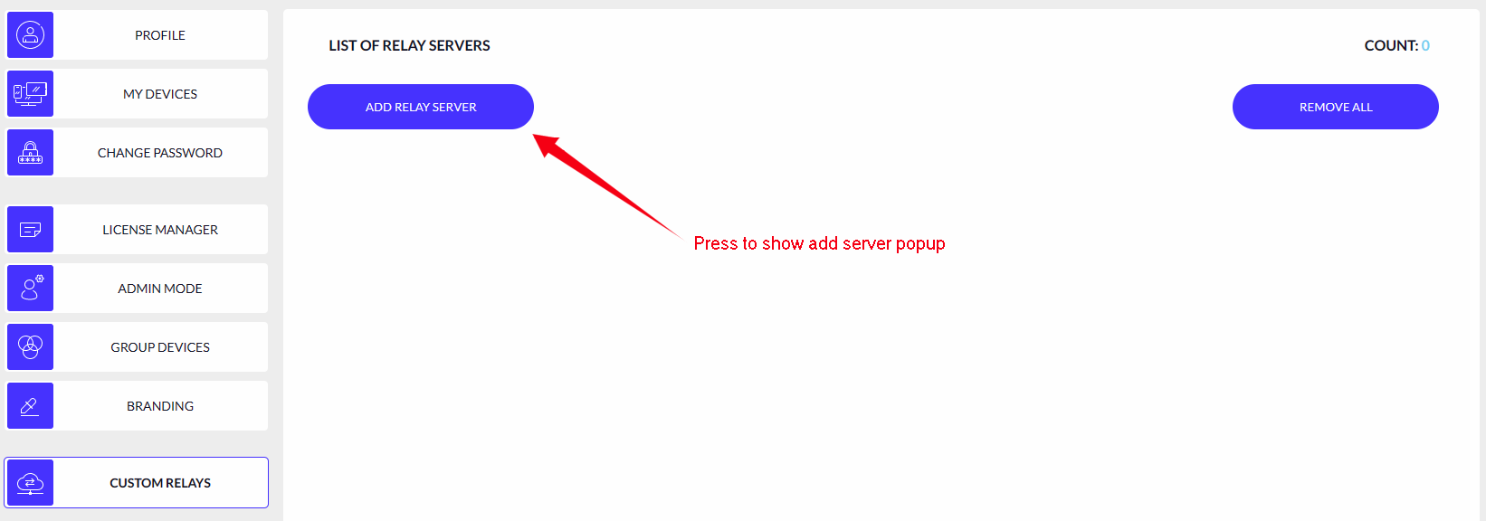

4. Registering the relay
Log in to your account at remotly.com, go to CUSTOM RELAYS, and click Add relay server. Provide:
IP address of your relay server
Port from RelayGoConfig.json
Password (if set, currently not supported)
Once configured, when connecting to another computer with Remotly and Force Connect Anywhere is enabled, you should see only the country code of your relay server.
