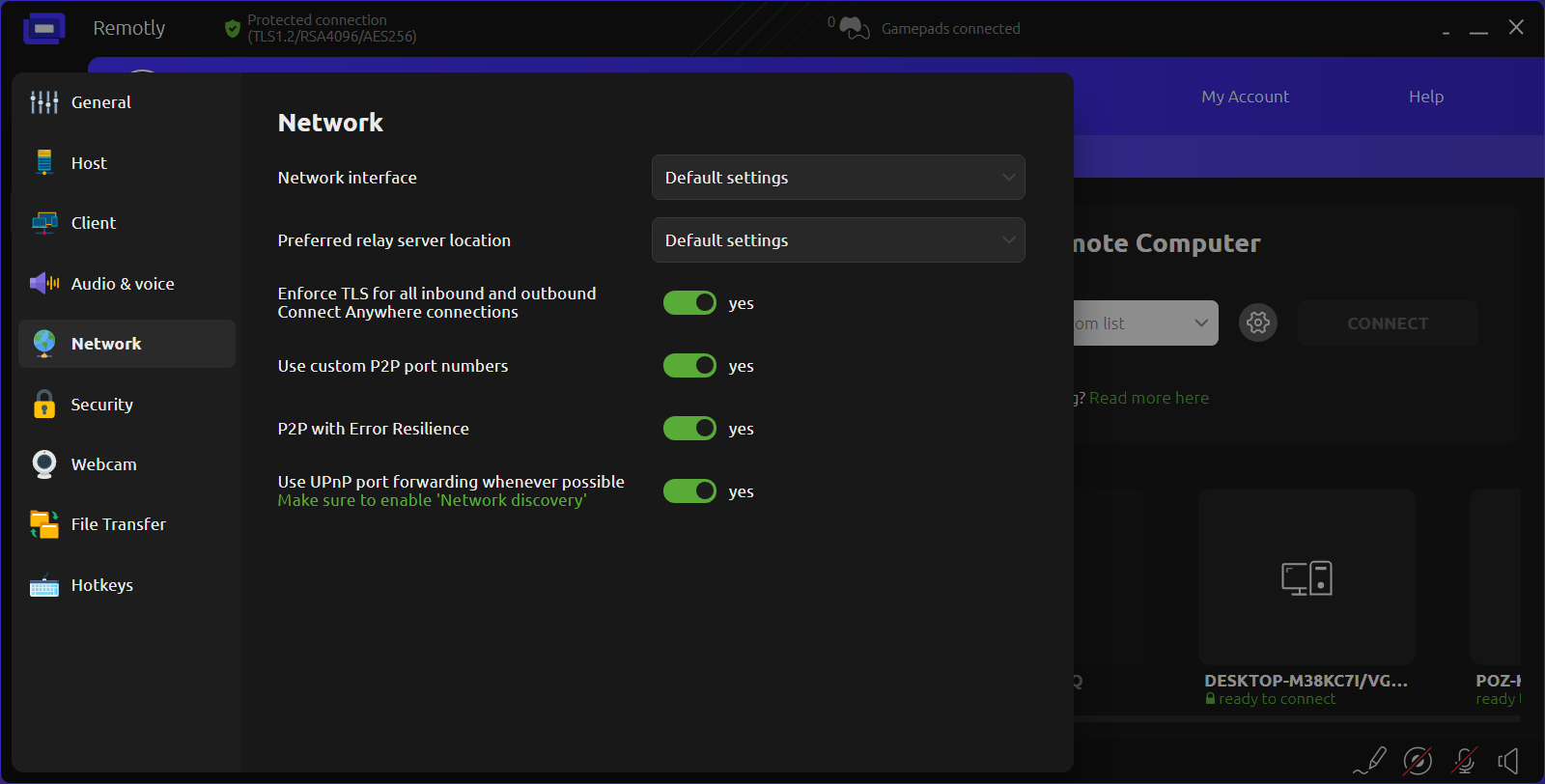

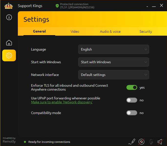

- Enforce TLS for all inbound and outbound Connect Anywhere (relay) connections.
This new option forces encapsulation of the already end-to-end encrypted data in TLS 1.2 or 1.3 protocol. This is needed when Remotly is run in a network environment with TLS inspection or aggressive network traffic filtering.
This option is also available for Remotly QuickHost (General Settings):

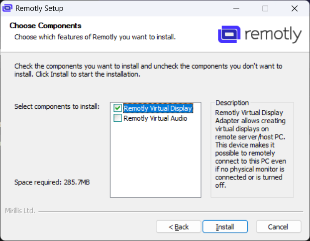

- Installer improvements.
"Choose components" can now be used to select which Remotly drivers will be installed together with the main application. There is also a new USB-P (USB Pass-through) driver coming in version 1.40. This driver allows using of devices connected to the client side on the host side just as they would be connected physically to the remote host. It is now possible to install the drivers in silent mode using "/install_drivers=yes" option when starting the installer from command line (please make sure to add /S option which forces silent installation). The "/install_drivers=yes" option is also available for Remotly QuickHost for easy silent mass deployment.

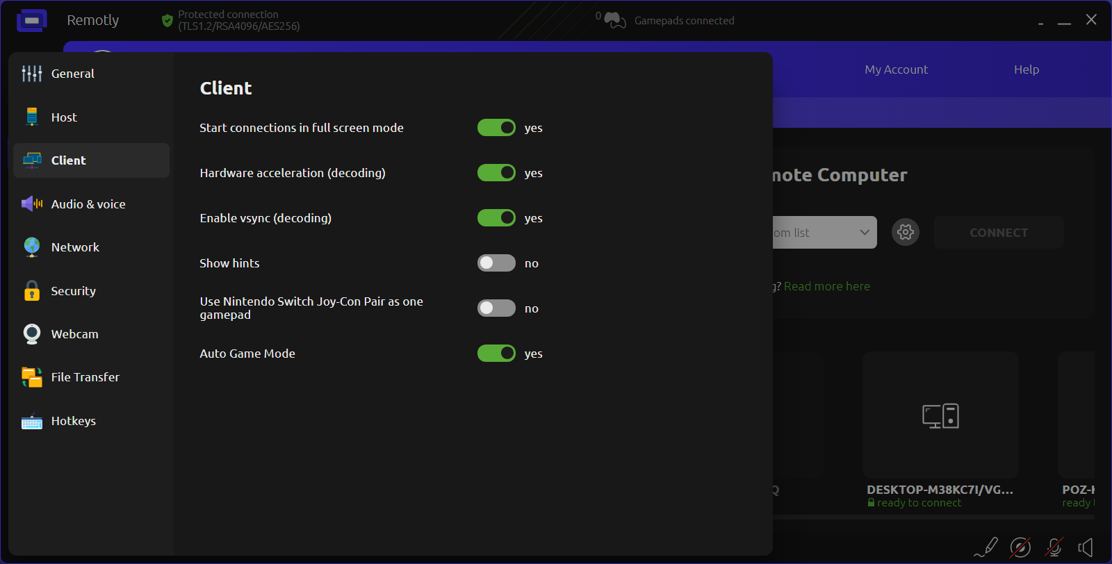

Remotly PC Client
- Start connections in full screen mode
This new option allows starting of connections in full screen borderless window. The position of the window where it was last positioned is remembered for each remote device separately.

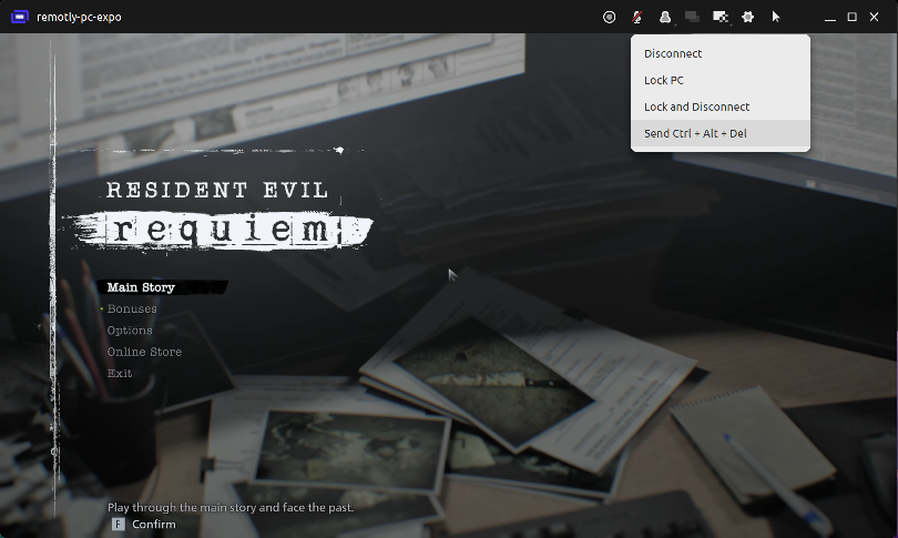

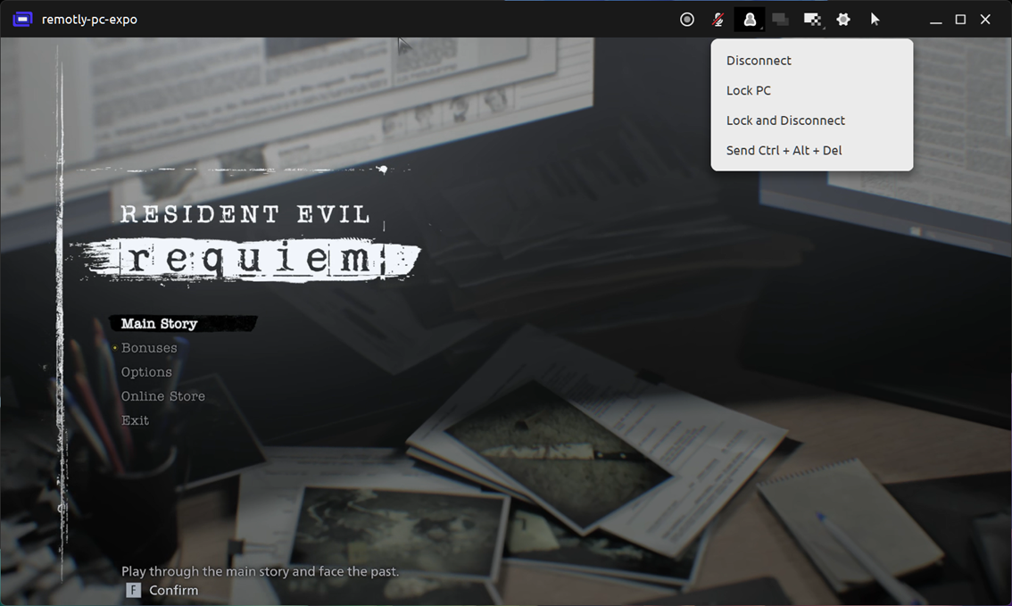

- Removed video dimming when on-screen menus and dialogs are visible.

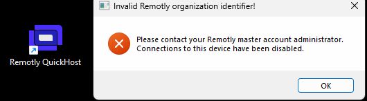

Krzysztof Goral
Hey,
After updating QuickHost on a remote machine, I received the message "Invalid Remotely organizations identifier!"
Please contact your Remotely master account administrator. Connections to this device have beeb disabled.
Hi Krzysztof,
Did you run the new version with the RemotlyQH_<organizationidentifier>.exe name?
Hey,
Yes, I've linked it on my website :)
I try to uninstal and reinstal and same story...
So you installed the new update over the previously installed version using the RemotlyQH_<organizationidentifier>.exe and after the installation when trying to start Remotly QuickHost you get the "invalid organization identifier" error?

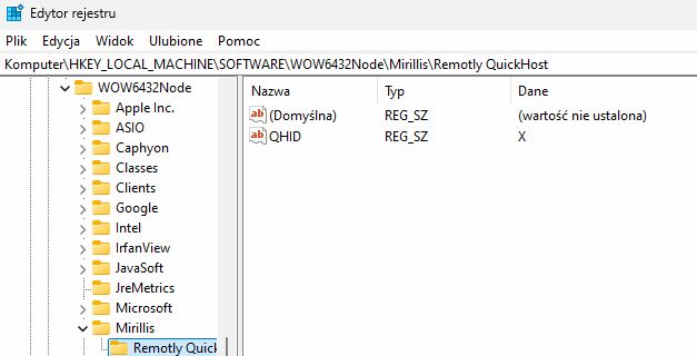

Please run regedit.exe and check this registry key:
HKEY_LOCAL_MACHINE\SOFTWARE\WOW6432Node\Mirillis\Remotly QuickHost
You should see a value named "QHID" with the your organization identifier there.
Please let us know if you see this value.
BTW. Do you still have the previous installer (1.39.2)? Can you try using the previous version and let us know if it still works?
Hey,
Dera Krzysztof,
We have checked your license and organization identifier and they are OK.
There must be some other issue. Maybe a firewall is blocking RemotlyQH from accessing network?
OK, its working :)
We have double checked this and there is only one way the QHID can be set to X during QuickHost installation. If the name of the installer is not 22 characters in length. When QuickHost installer is downloaded from the Remotly admin panel the length of this name is always 22 characters. If it's changed the installer won't work and will throw "invalid organization identifier" error.
Krzysztof Goral
That should be fixed... first instalation goes from RemotlyQH_xxxxxxxx.exe and update from RemotlyQH_xxxxxxxx (1).exe. Maybe You shoud think about autoupdate for that host? For me if i must manualy update all my hosts that's goin to be not so funny :)
OK "RemotlyQH_xxxxxxxx (1).exe" explains everything :) It will be fixed in v1.39.4 update tomorrow to work with (1),(2)... suffixes.
There will be an auto-update soon. We do not want to force updates by default so it will be executed through the admin panel. The admin will be able to test the new update before rolling it out to all the hosts he manages.
We are also adding full Microsoft Entra ID integration (formerly Azure AD) from version 1.40.0. This way it will be possible to mass update hosts using Microsoft admin panel.
The problem with RemotlyQH installer name has been fixed in v1.39.4 which is now available for download in the admin panel.
