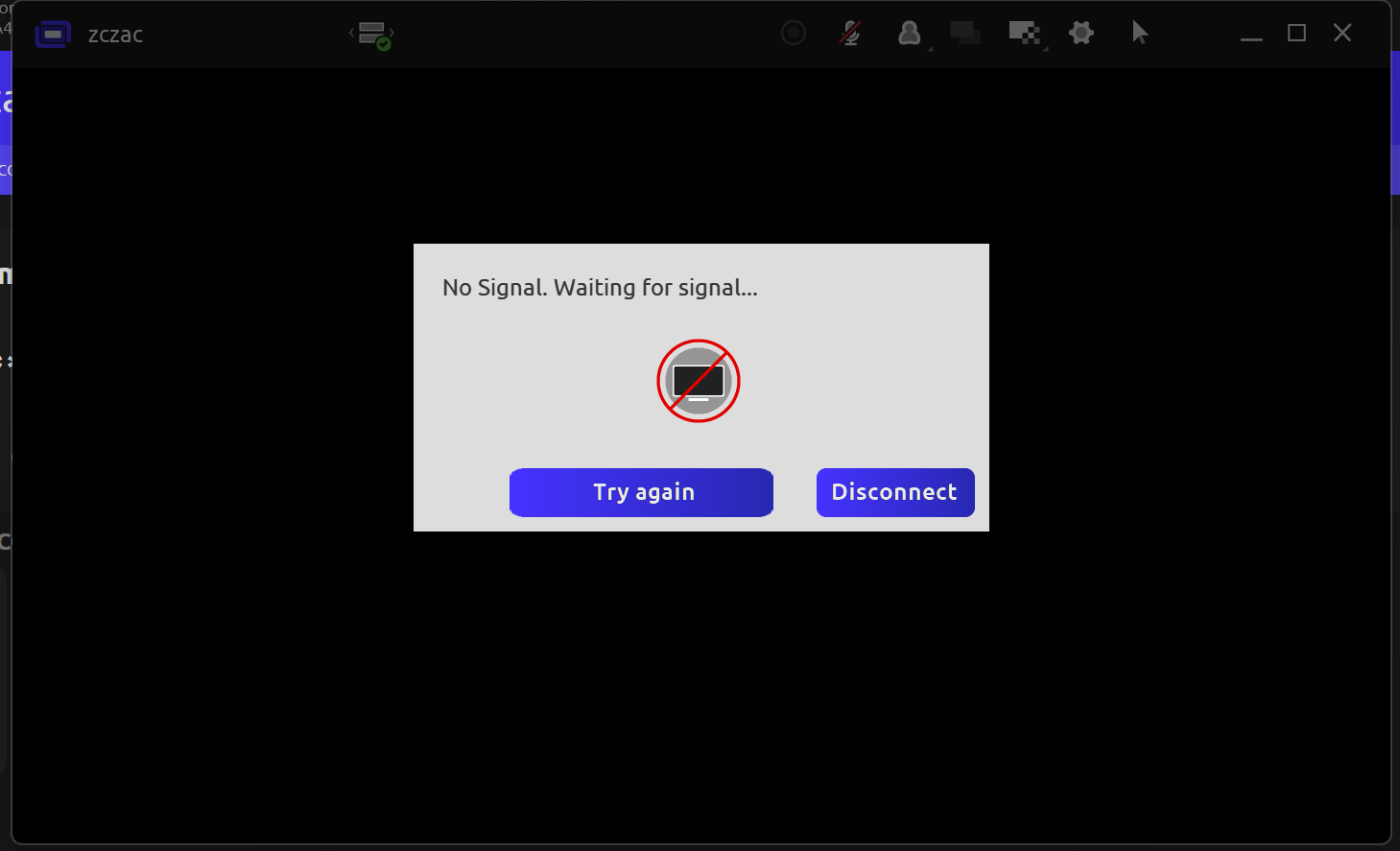

So, it did happen again this morning. I went back home to pick up my laptop and checked the device to see if only the client is frozen or the entire computer. The computer worked fine, and only the client was frozen, so I left it like this and went back to work with the laptop.
I have tried to use the laptop to access the computer, and I do not get any connection errors. I can connect to the remote computer, BUT I cannot access it. The screen is black, and I get a "no signal" pop-up message.
I have tried the option to reboot the remote computer, but there is none. I can only lock or send CTRL+ALT+DEL to the remote device.
I have attempted to send multiple CTRL+ALT+DEL commands to the device, hoping that it would force a reboot, but it did not happen.
I am unsure if this panel is the admin panel you mentioned, but I could not find any other settings or panels for this remote device in my client.
If there is another way to open a different admin panel, then please let me know.

When you see the "No signal. Waiting for signal.." please disconnect and use "Force compatibility mode" option on the connecting client for this remote computer. This will skip all hardware accelerations and let us know if this is some kind of display/GPU problem or a network problem.

Tried enforcing compatibility mode with and without the Connect Anywhere feature. No difference. Still black screen and no access to the remote computer. It only works on the lock screen.

Do you see video in lock screen and not in desktop?
I can see both, but after login to desktop my PIA VPN starts connecting and this is when I lose the picture and everything goes black. It should not interfere because it's set to connect via tunneling.
When I get back home I will try to completely remove the client and reinstall it. Maybe this helps.
Now i get it! Ok so it is a network problem after all. Please let me know what network devices do you see Settings -> General -> Network Interface.
