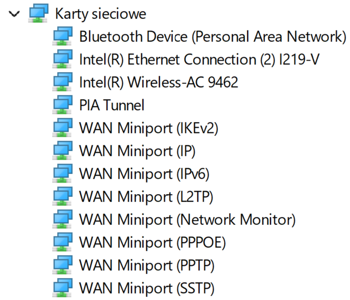

In Windows 11 I have no such thing as Settings > General> Network Interfaces, BUT I have made a screenshot of all network devices on the computer in question. It is connected with an Ethernet cable to my home PoE network and then to the router.

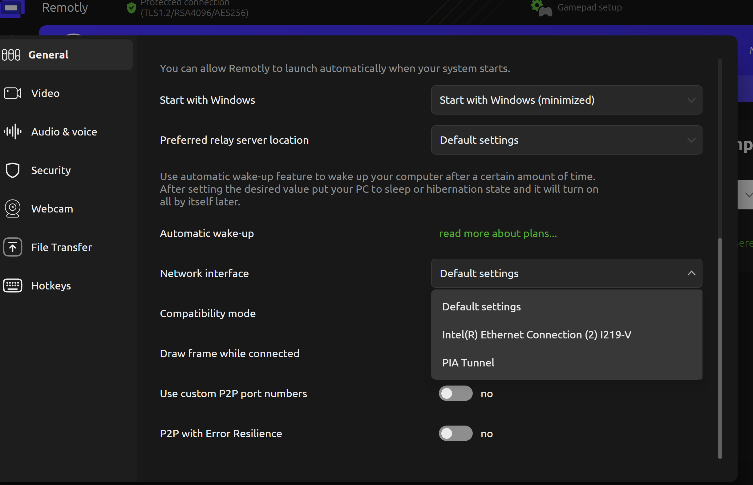

You should see PIA Tunnel on this list. If it's there please select it and then check if this helps.
I do have PIA Tunnelling. My setting is default.
I will change to PIA and let you know tomorrow if anything has changed.

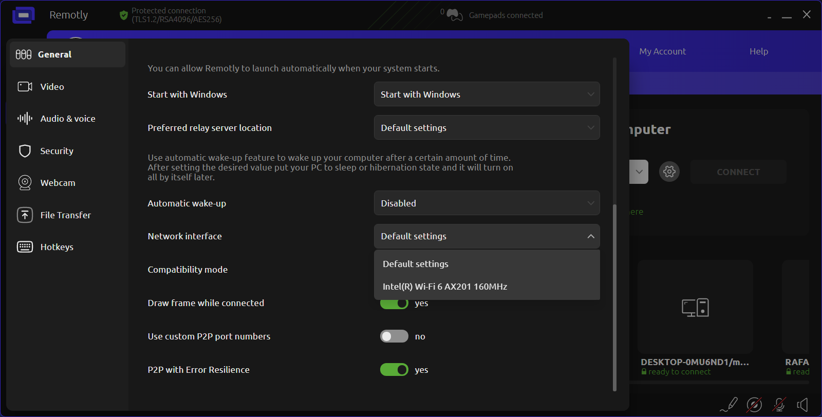

I am curious why the default setting works on my other two computers without issues, but not here.
"I am curious why the default setting works on my other two computers without issues, but not here."
I'd need to see the Network Interface list on those that do work. Maybe they are in different order (maybe PIA Tunnel is just under Default settings).
ZiggyGG
Just checked. One of them was defaulting to the regular connection (so via VPN?), and the other one had PIA Tunnelling as the default connection.
Both worked fine. I don't know anymore. I've set all to PIA Tunnelling. Testing tomorrow at work. It's late here already.
