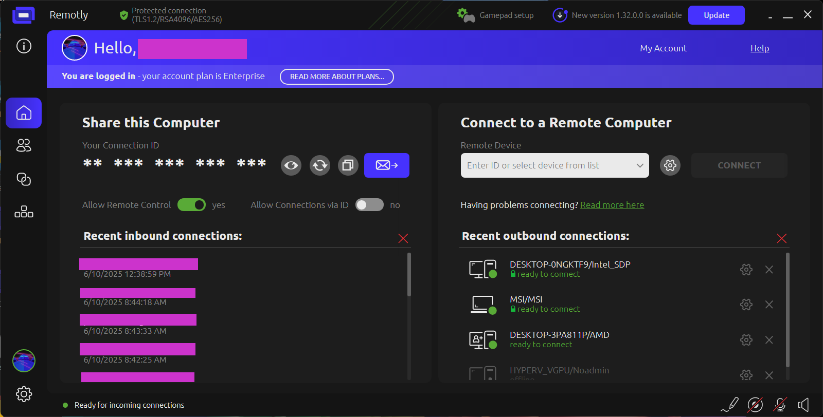

This is a BIG update and we hope it will not introduce new problems:
1. Hyper-V now uses low-level capture engine for all user accounts when booter service is running
2. Booter service in Hyper-V does not use low-level capture engine (but can use hardware acceleration)
3. For best performance it is recommended to connect to full version (booter should be used for supervisor purposes)
4. The UI has changed and adds list "incoming connections". This allows quick monitoring if someone has tried to connect to our host machines...
