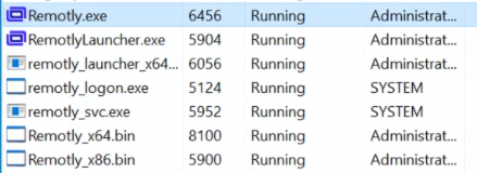

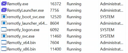

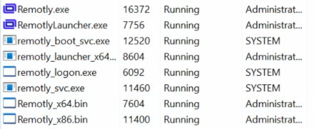

To make sure we don't waste time for one-ff, I did a fresh install.
Fresh VM installation of Win Srv 2022 without GPU-P. enable GPU-P and install AMD drive inside VM. reboot, and install remotly (run as admin). after installation, during UI loading, VM crashes. shut-down VM, disable GPU-P, boot VM, run remotly, login remotly.
at this point, no matter what I do, could not get remotly_boot_svc.exe to appear in task manager.
Shutdown VM. enable GPU-P. boot-up VM. well, it works now. remotly_boot_svc.exe runs. UI now appears, and remotly_boot.exe not in task manager.
In this freshly installed VM, "LastUser" is "Administrator"
In the previous VM, "LastUser" is "administrator". hmm. realize that this VM is a domain controller, maybe this is the difference.

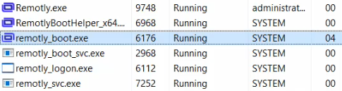

beat the dead horse one last time. using the official 1.33. install w/o GPU-P (hence no crash), then enable GPU-P.
remotly_boot.exe still sticks around preventing remotly.exe from starting and it is consuming decent CPU time . if manually kill remotly_boot.exe, remotly.exe start right away and works fine.
on the booter process, seems that an explicit logout/login (not just restart) is enough to get it running.

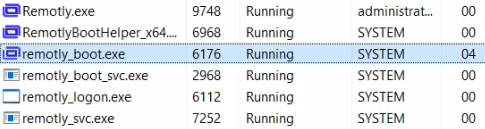

Actually this sentence:
remotly_boot.exe still sticks around preventing remotly.exe from starting and it is consuming decent CPU time.
may finally help us in locating this problem.
